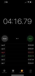

@1poolman1 Thanks. I just got back home and tried the suggestions. Because the pool setup is bit tight, couldn't go very close to view inside thru small holes in the pump casing. But I'm able to observe the following:
1. The shaft from the motor casing to the impeller housing being stagnant and not turning when the cleaner circuit is turned on.
2. With a popsicle stick, I was able to feel, the motor casing vibrating for 4-5 seconds and stops. Accidentally, I was around and noticed it waited for about 2 mins and the cycle repeats i.e. motor casing starts making normal sound and vibrates for 4-5 seconds; stops; repeats again in 2 mins.
Attached timer laps for reference. Lap 1 is start; Lap 2 is the wait time before next round; and so on.
Does this mean, the motor is OK and there is some kind of safety mechanism which stops the motor if the shaft is not moving the impeller or the shaft itself is stuck for more than 4-5 seconds and retries again? Not sure whether such smartness will be inbuilt in these booster pumps but my observation so far alludes that way. Any bells ringing for you and rest of the TFP fam?
Motor is not turning though it is being powered. It overheats and trips the protection device, cools and starts the cycle again again. Most likely bad bearings from a seal leak, but anything that prevents the motor from turning will cause this.
