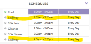

This is my schedule...
This is my pump schedule...
Did u base your spa flow requirements on turnover or something else? Is there a recommended turnover rate to keep the water clear if I was picking a rate (gpm) and time to run water to the spa?
My spillway runs at 1700 RPM and my VSF pump says 44 GPM.
In 20 minutes that is 880 gallons put through maybe a 500 gallon spa twice a day.
Your pump is going to push more than 40 GPM if you have a good spillover flow. Run your spillover for 20 minutes or so twice a day and you will be fine.
