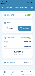

Recently had my IC 30 connected with my new pool. All was working normally until PB hooked up automation using the Pentair home app. I have a 3hp vsp, and using intelliconnect automation. My FC kept dropping to close to zero, forcing me to use LC. When I checked the IC30, no lights were on, I had to disable the IC in the app and enable it again for it to start. If I run the pump manually for cleaning or change the speed it shuts off and again I have to disable and re-enable it in the app. Now it is stuck in boost mode in the app, even though it is not running. The app says it's running, but when I physically inspect it is not on. I never know when it is on as what the app is showing is incorrect.
1. How do I pair a new device to the intelliconnect? I see I can delete it from the app but do not see options to add. At this point want to start over delete current IC profile, re-add and resync.
2. Confirmed it has power as it is connected to relay one on the intelliconnect.
3. All other connected devices are responsive and work as expected with the automation, Pump, Heater and lights. The pump will not go past 85 deg in automation mode but will when I disable remote at the unit. Still need to figure that out
