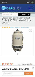

Was quoted $1750 to install a pool chiller in Palm Springs, CA. He also is going to set my Pentair phone app to run the chiller on a schedule. I realize that’s not a big deal, but some installers don’t even mess with the automation part of it. It’s 108 degrees, so I’m willing to pay more for them to work in the heat. Is $1750 a fair ballpark for a chiller install? Thanks for your help 🤙🏾
If you install that chiller, be sure you are using softened water for fill water. It is an evaporative chiller. So your pool water evaporation will go up quite a bit.

I ended up supplying the chiller and paid a different installer I found in town $500 for his labor and $270 for the valves and pipes he bought at the store before he came over for reimbursement. Turned it on tonight for the first time. I didn’t automate it because I would need to buy 2 actuators and combine my pool and spa lights to free up a spot for the chiller. Installer also said these are tough to automate, due to the chiller water flow valve having to be adjusted so often to match the pump speed? I’ve been trying to keep it from overflowing the basin for the last few hours. Tough to get the valves set correctly.
