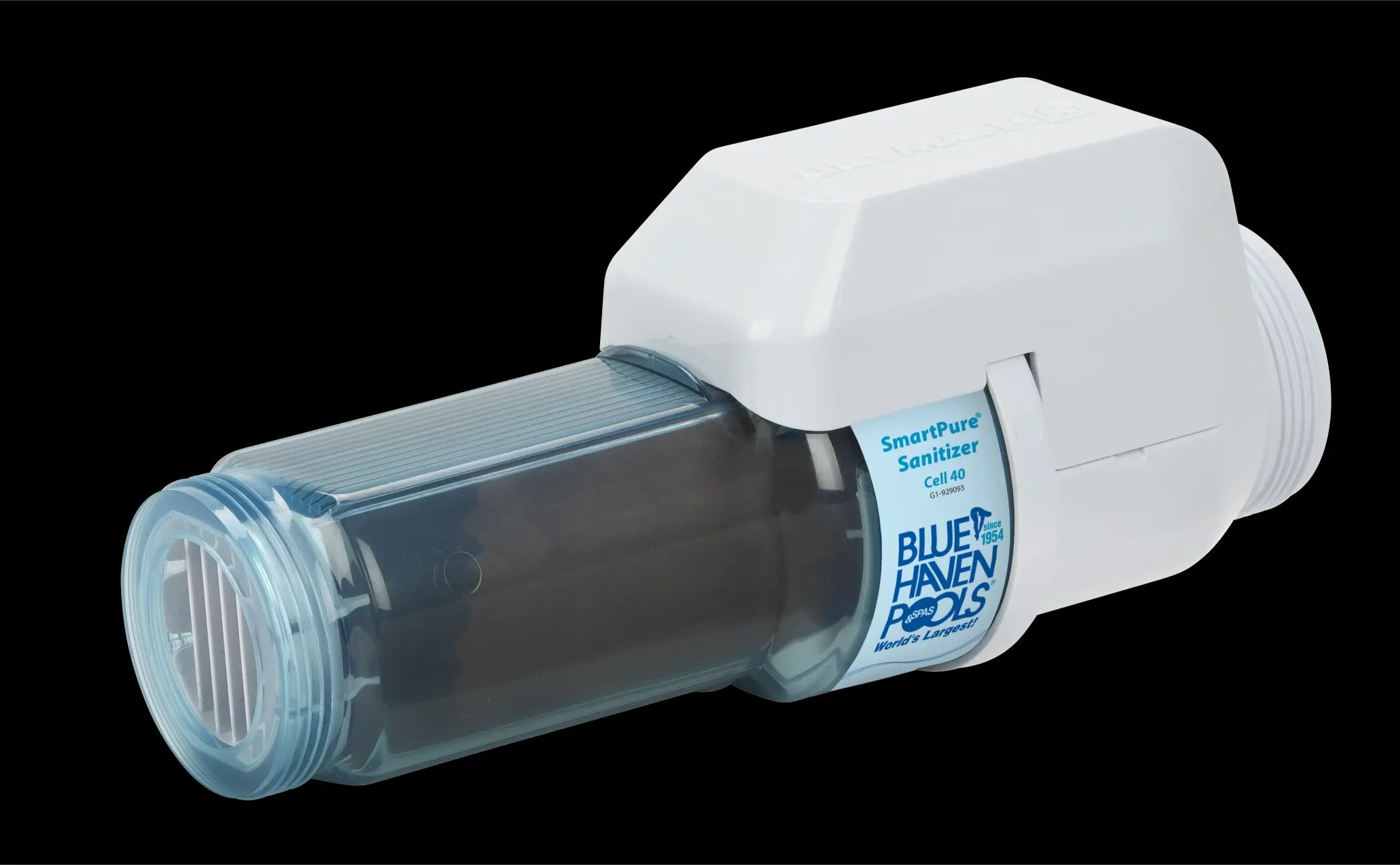

See pics for SWG and control panel.
On the SWG cell, there is only one label that I see with any real information. On the body of the cell itself it says "SmartPure Sanitizer and that's it. I don't see any T-anything.
We didn't opt for any automation, nor did we pay for any, nor did they show us any. I don't think we have any. Or maybe I'm thinking of automation in different context.. as in the $800 system we could have added on, but didn't.

You need to do the FAS/DPD chlorine test in your TF-100. The OTO yellow chlorine test only tells you if you have chlorine. It’s results are not accurate. Do you know what that test is?
You have a Hayward Prologic automation system.

Does your cell look like these cells with the blue label?

You have the Hayward Prologic PL-P-4 system. This is the manual...
See page 13 - Configuration Menu - where you can display the cell type. Go to it an see what type cell it is set for.
Press MENU then >>>>> to CONFIGURATION MENU then + to select CHLOR CONFIG then >>> to display cell type.
"Configuration Menu Locked" ☹
Photo of the cell. I was trying to keep the company name off the thread but it's inevitable.

Your pool was new construction?
And the pool builder gave you a non- Hayward aftermarket cell? Did you know that is what you were getting?
