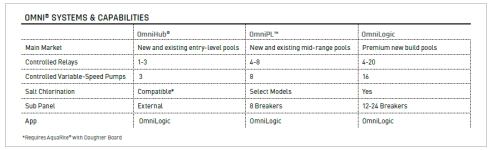

Should I go wirh omni logic or omni hub. I want to control vs pump, heater, light, swg maybe a few valves and other lights. I like the logic as it has the load center built right into the unit, makes for a cleaner install. I also am thinking omni logic is more future proof for automation going forward...Is the logic an overkill for my situation being I only want to control 1 body of water...

Only reason to get an Omnilogic over OmniPL is the extra amps and extra breaker space. Omni PL only has space for 8 breakers. I’m not sure but I think the Omni Logic can have 10 as well as 8 high voltage relays.

I think the pl would work...so this seems like the better option than going with the omni hub? My pb recommend the omni hub/pump combo but the pl will give me a cleaner install....
See the attached Hayward Omni Brochure.
Are you getting a SWG? Get the S/PLUS model OmniPL.

With the OmniPL you don’t need a separate card or Aquarite panel the OmniHub requires and i think Hayward has an OmniPL bundle with the cell at a reduced price.
You wouldn’t need The Aquarite. An Omni PL will do it you just need the salt cell.
