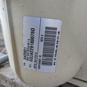

Here's a picture of everything I thought was relevant. It's an older pool as you can probably tell. There is no side port for running a vacuum, you have to do it through the skimmer. There is a second port in there that is plugged, not sure what that is for. The valve on the pump, not sure what that is for either. You can see the fancy refill mechanism for the pool water level, a pipe that points a stream of water into the pool. :poop:

Your set up looks pretty straight forward. Looking at your pics I see you can use a new pressure gauge. I got the one from TFTestKits.. Its really nice. But before your you order. have you looked at the condition of your filter grids? And I don't know how much of the equipment you are planning to upgrade/replace. It looks like you are using an older DE filter. You should pop that bad boy open check the condition of the grids and put new DE in along with the new water. If the grids are all busted up it might be time for new grids or an upgrade to a cartridge filter. check this out
Your pump looks good. I not surprised you have to put the hose in the skimmer intake to vacuum.. that's the old school way to do it. You should look into a robot if you want to give that task to someone else.
