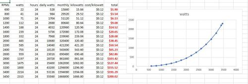

Ive been talking to a few friends that have pools and some are saying stick to a basic 2HP pump, yet others are saying variable speed. Ive read most people (newer builders) are going VS and just trying to figure is the savings and maintenance over the long term, worth it up front.
In the United States, variable speed (VS) motors will be required for all pumps over 1.1 total HP as of July 18, 2021. Purchasing a single speed pump or a 2-speed pump now for a new pool is discouraged.
A 2hp pump will use over 2Kwh of electricity. A VS pump running on low speeds will use 10% the electricity of a SS pump as illustrated by the chart above. A VS pump can pay for itself in energy savings in a few years.
Reactions: Nikilyn
