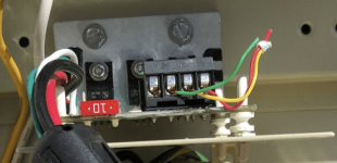

Just for reference: My surge board (which didn't come with my EasyTouch, but rather came out of the Pentair Power Center power supply for IntelliChlor) has an auto-type fuse on it. It's a 10 amp fuse. I have an IC40, and it's never popped that 10 amp fuse, even though my IC melted a connector similar to the one you had that fried.
