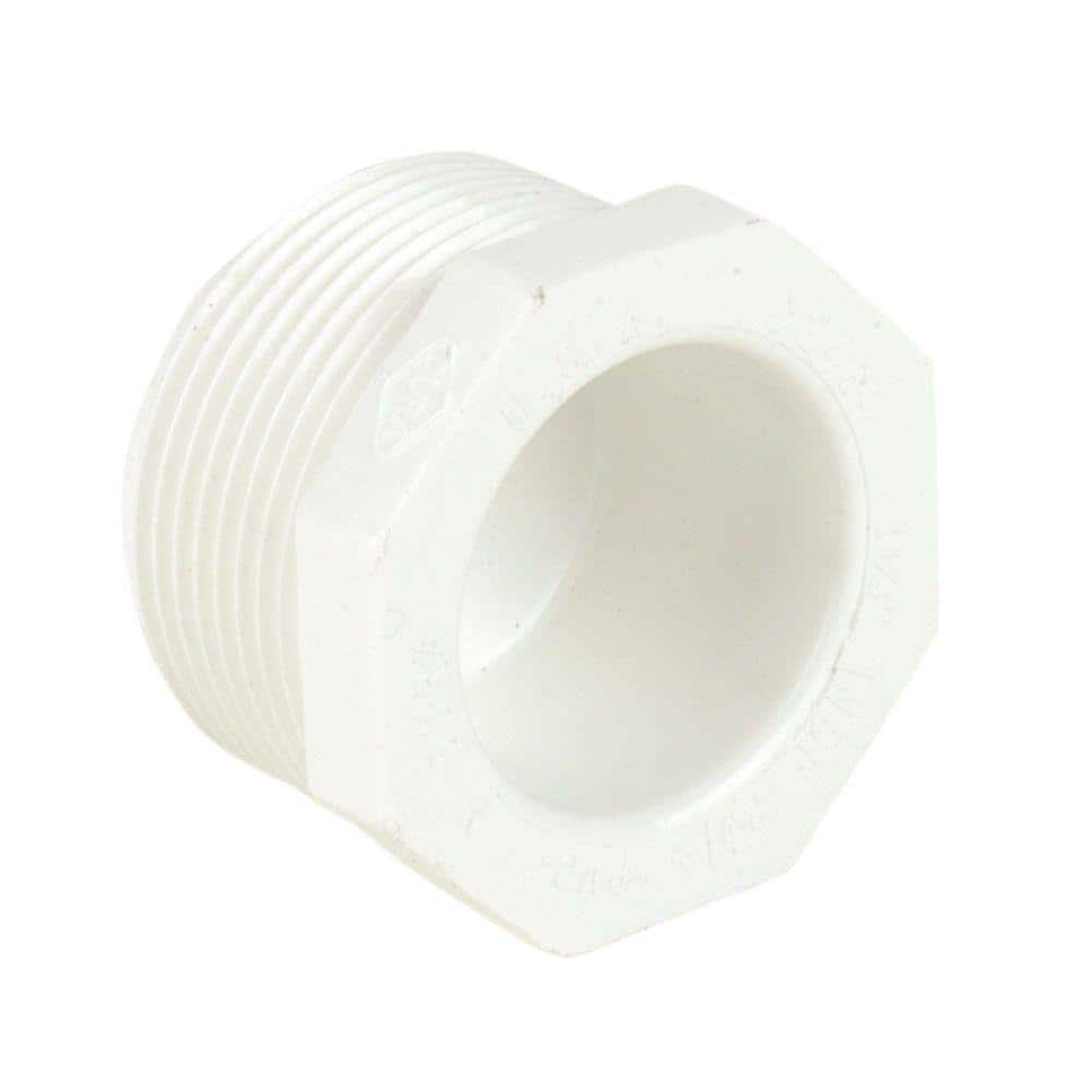

You can also remove the flow switch, screw a 1/2" npt threaded plug into the hole, turn on the system and manually close the flow switch to see if it works.
The hardware store should have a plug and cord that you can use. The cord will have 2 or 4 wires. Just connect all wires together with a wire nut. That will simulate a closed flow switch.
Also get a 1/2" npt pipe plug for the other test.

I tried finding the 1/2" npt plug but I cant find one in HD. should I go and browse the plumbing section?

Search for 1/2 pvc plug on Home Depot site. They have them. That cord will work.

Actually, since you have a VS pump, just turn the pump off at the pump control while leaving the box powered. Leave the box switch in the OFF position so that the cell doesn't generate with the pump off. Unscrew the flow switch and manually close it to see if the no flow goes away. You might have to temporarily move the box switch to the auto position, but only do it briefly.
Any hardware store will have a 1/2" PVC pipe thread plug if you want to do it with the pump on.
