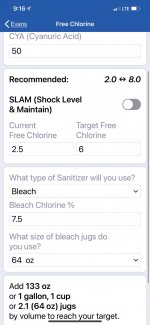

OH ok I gotcha on the math here, but I'm confused how I was supposed to enter it on the app. It looked self explanatory but apparently I did it wrong cause it only told me add 19 ounces! I really want to try and understand this. Where are you getting that 38 ounces of 7.5 equals 1ppm???
Look at the picture of the web version of PoolMath I posted. I played with the numbers and told it you have 0 ppm of FC, but that you wanted 1ppm of FC.
I like to tell folks exactly how much of their chlorine (the 7.5% you have) will give them ONE ppm. It will always be 1ppm of 7.5% = 38 ounces.
So someday you say to yourself "I need to increase my FC 3ppm.... I know that 38 ounces is 1ppm, so I'll just multiply it quickly in my head x 3ppm". You see? Faster than using the PoolMath as long as you're using the same product.
