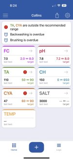

OK, we got our test kit yesterday. Results are as follows:
FC 7.0
CC 1.0
TC 8.0
pH 7.8
TA 110
CH 150
CYA 47
Salt 3000
Attached is a test we got back from our local pool co yesterday. Salt and chlorine seem to be in total contradiction between my tests and the pool co. Chlorine I tested twice with the exact same results...
Any thoughts/ guidance would be greatly appreciated.

Round up your CYA to 50.
The CC of 1 is a concern. Test that again tomorrow.
Keep pH in the 7's.
Did not look at the pool store test. Use your own testing.
Reactions: Mdragger88
I’m going to echo what MK said above about your combined chlorine (CC). You might have an algae issue and one of the best ways to check that is by doing an OCLT (overnight chlorine loss test). Perform the Overnight FC Loss Test (OCLT)
Your FC of 7 looks good but, if you follow the OCLT to the ‘T’ and you lose more than 1ppm of FC you may need to SLAM your pool. SLAM - Shock Level and Maintain

App question 1- I have it tracking CC as you can see on the attached "logs" page, but it does not show on the summary page. Is this an issue with the app or a setting I have wrong?
App question 2- Will the app make recommendations as to what needs to be added to the pool to correct numbers that are off? I have not found it so far, but the description on the "Pool Math" link to the left says "takes all the guess work of how much chemical to add".
Soooo, what do you all think about our numbers? The app thinks TA and CYA are out of range. Do you agree? Assuming so, how much stuff should I add? I have a note that to raise alkalinity I should add baking soda, but to lower it? Also, FC appears to be dropping slowly, should I bump our percentage up on our SWG? It is currently at around 55%.
Thanks so much to everyone here for the help!!1D890BF7-1F0B-4FDC-848B-6CD630DE10E4_1_105_c.jpeg5897957A-1025-4BF8-B1D4-00F58BA5D820_1_105_c.jpeg82D1515E-1813-4E35-AC7B-E579DA9ECC85_1_105_c.jpeg

1. CC is the same thing.
2. Click on any of the items with the red exclamation point and it’ll give you a recommendation on what to do. But realistically you don’t need to do anything with those results. The TA will come down on its own and the CYA is fine for now.
3. The electronic pH meters are a pain to maintain so I’d count on using the drop test long term. Being off by a small amount isn’t a big deal. As long as the pH is 7.something it’s fine.
When you click on each card in the overview it will show the recommendation.

the cc’s info is kept in the logs so you can review it, it just doesn’t display on the overview cards.
