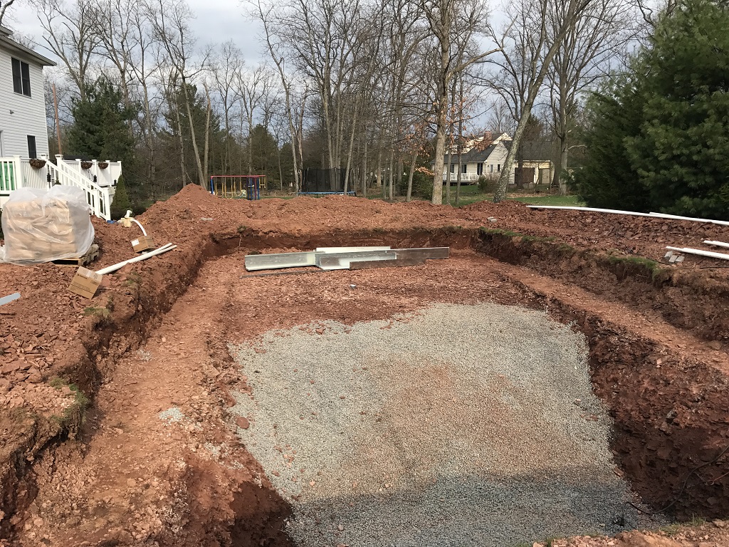

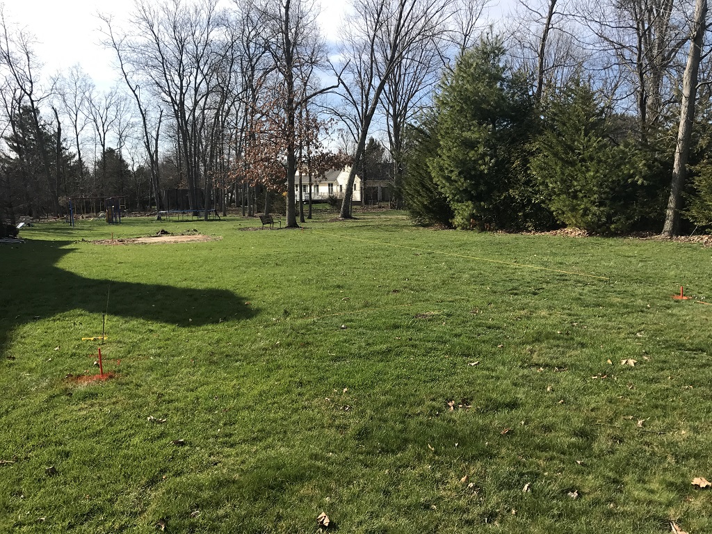

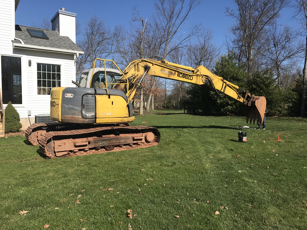

After a long winter we have finally started the real work....
Markings and strings where they will dig....
Digging machine stretching it's arm....
There goes my lawn....

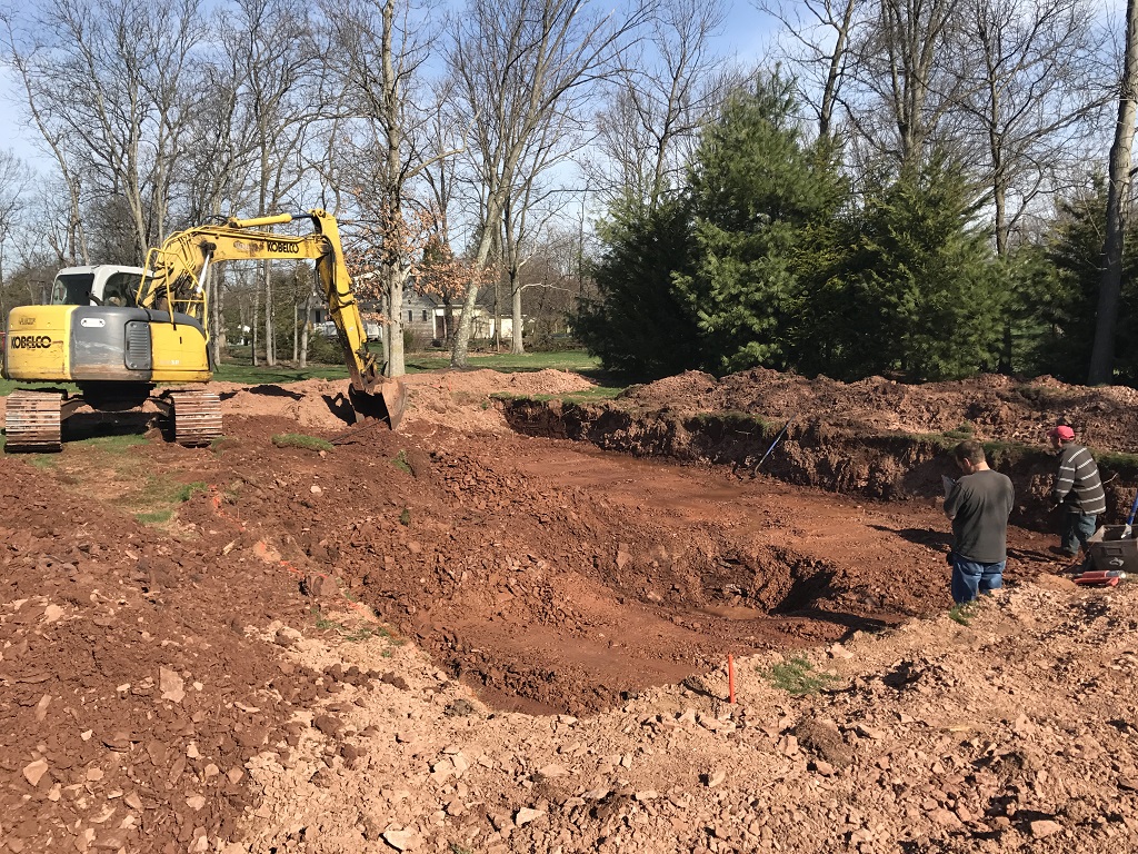

Dirt, dirt, and more dirt everywhere....
Digging is done....not the best pic though...lol....

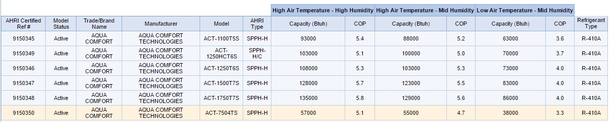

Heat pump question....
Builder priced in an AquaComfort ACT-1250. I told him I think that's too small.
He's willing to upgrade to the ACT-1500 for free and eat the cost difference.
My question is should I pay to upgrade to the ACT-1750 for around $1K (still finding out exact cost). Keep in mind the pool is 24x50. I don't plan on a solar cover, and plan to run it 24/7.
I looked on the AHRI directory and found this...
Diff between the 1500 and 1750 doesn't seem to warrant the big difference in cost IMO.
Sorted it out. Builder was very gracious and upped it to the ACT-1750 for no charge.

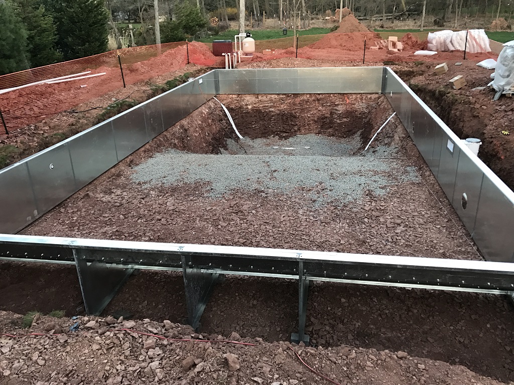

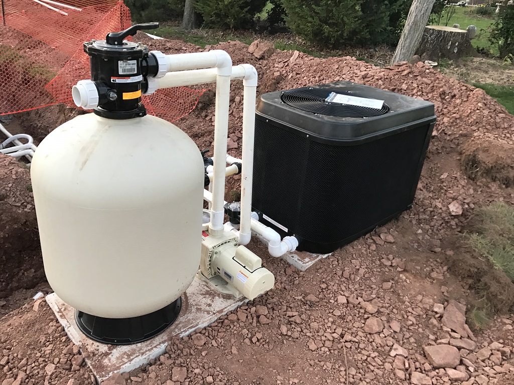

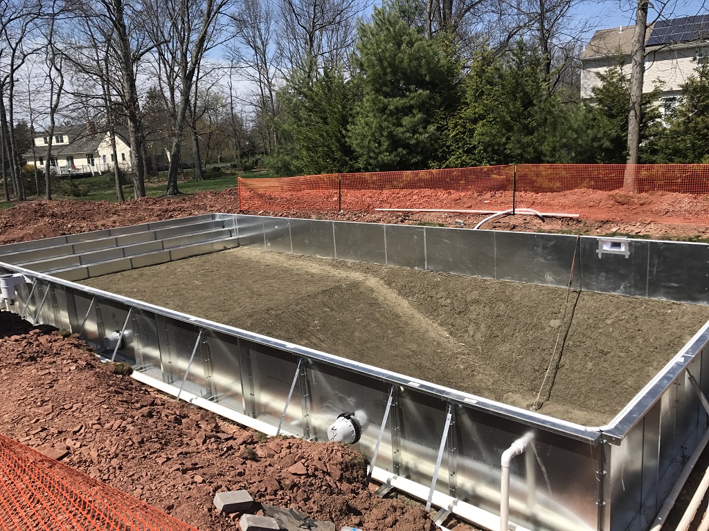

More pics...
The framing....
The framing from the shallow side...
The equipment....nothing magical here....

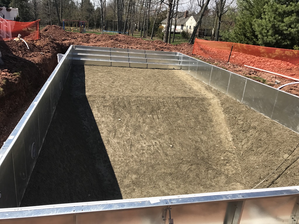

Here are pics with the concrete....vermiculite to go in tomorrow.....

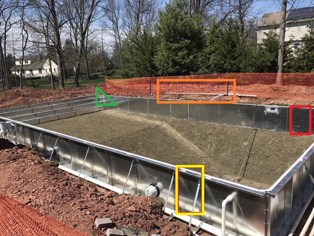

I'm trying to figure where to place all the ladders, handrails, etc. The slide will be in orange with the steps on the left (shallow side), with the mouth on the right (deep side).
I'm thinking the handrail will be in the green location.
Situation...
Right now I have one ladder planned. I'm not entirely sure where to put it. Would it make sense in the red location? That way someone going in from the slide would come out easily? or do you think they would rather just swim over to the shallow end and get out? Keeping in mind that there may be weak-moderate swimmers using the slide.
On the other hand, the patio is on the yellow side so it may be more convenient to come in and out vs going all the way around the pool.
Any thoughts on what I should do?
Can I easily add ladders later? I think bonding may become an issue.

I would put the ladder by the slide. Makes for faster out to do it again! Less chance of running round the long way and possibly falling or being pushed in. If the slide "pushes" them that way even better.
I have not idea how easy it would be to add a ladder later.

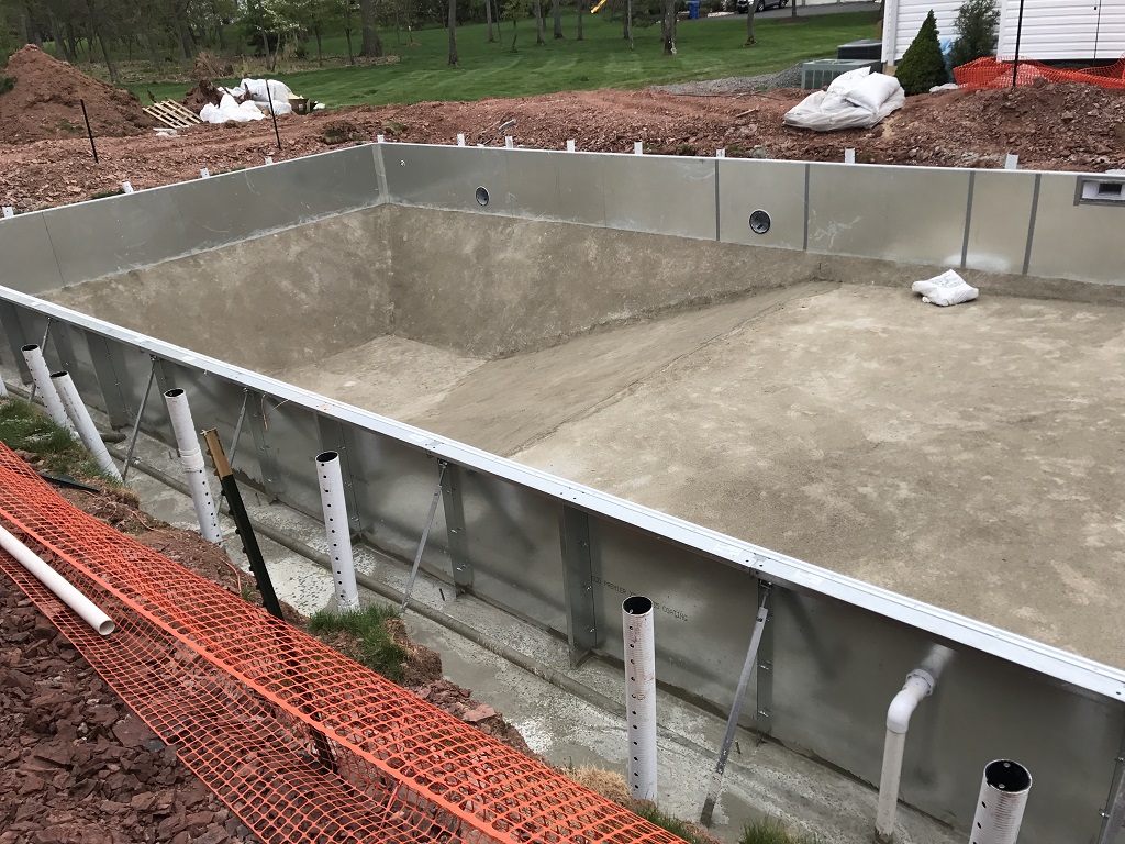

Updated pics....
- Concrete pour to secure the steel frame.
- Vermiculite on the concrete base.
- drainage pipes? Any idea what these are for and how they are intended to work?

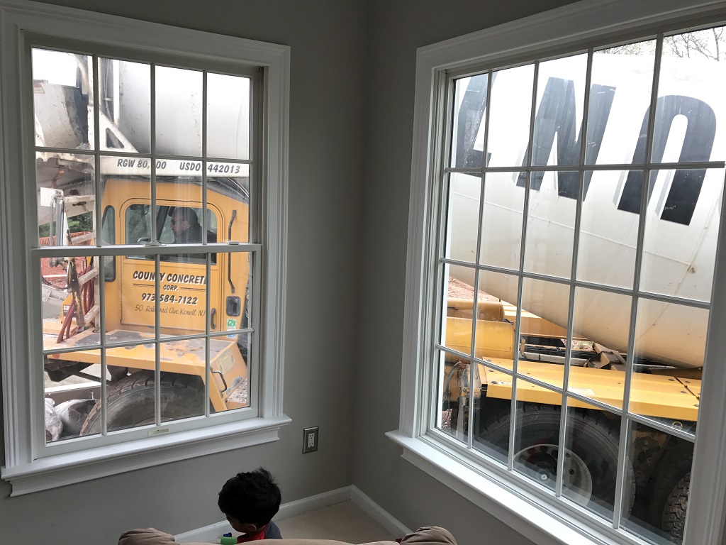

Concrete truck is mighty close....
