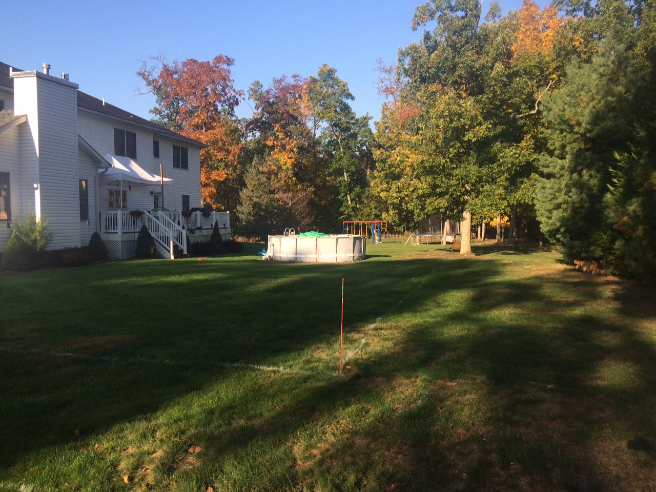

I'd love to get your thoughts on what we are doing...
Right now we have a blank backyard to start with. The deck is there, but no patios. We are the pool and 2 patios at the same time.
Some specs...
Pool:
24x50 vinyl
diving board
6 1/2' wild ride slide w/ water line
3 steps - 1x24'
depth shallow side: graded 3.5' to 4.5'
deep side: 9'
All Pentair equipment...
1 1/2 HP Superflo pump
SD80CP Sand filter
Intellichlor IC40 Salt water generator
ACT-1250 Aquacomfort heat pump
2 x Intellibrite 5G white LED light (thinking of adding a 3rd)
Kreepy Krauly pool cleaner
Decking will be stamped concrete.
I may be a little shaky on the specs, and how I organized it...lol.
Also we changed the size of the pool from 20x50 to 24x50, so I'm not sure if the equipment is now undersized.
Oh...we were thinking of going concrete, but that's an extra $13K. My wife would rather spend that on a bathroom reno in the future. Are we being stupid?
We're still sorting everything out.
Appreciate your thoughts :).

I would keep the first 25-30 feet about four feet so you can play volleyball in the pool, but your slide seems to interfere with the end where I think your volleyball boundary would be. You may not be able to move the slide closer to the diving board because it may interfere with it so maybe you would need to make the pool even bigger. It is probably safe to have the slide come into four feet of water ( the slide instructions should tell you that) but I suggest you have it come into five or five and a half (because legs can hit the bottom and some kids will go head first) unless you want the small kids to be able to walk once they come down the slide.
Check this pic I found. The have the slide going the opposite as mine. Maybe this is an option....best of both worlds. Only thing is I can't go 4' straight, I have a young child. The plan is to go from 3.5' to 4.5' in the shallow end. I think that should be okay for volleyball, no?
I would add some type of water feature because it is very relaxing.
I wouldn't pay extra for gunite but I would see if you could eliminate the railing walking down the steps ( and maybe you can replace the ladder in the deep end with a shelf). Not sure if that could be done in a vinyl pool.
Eliminating the rail....that may be a good idea. We do have grandparents that come over, I wonder if they will need that. One possibility...can I just move the rail over to the far side of the pool?
PB is coming Monday to finalize most of the changes. He should be able to help with some of these ideas.
