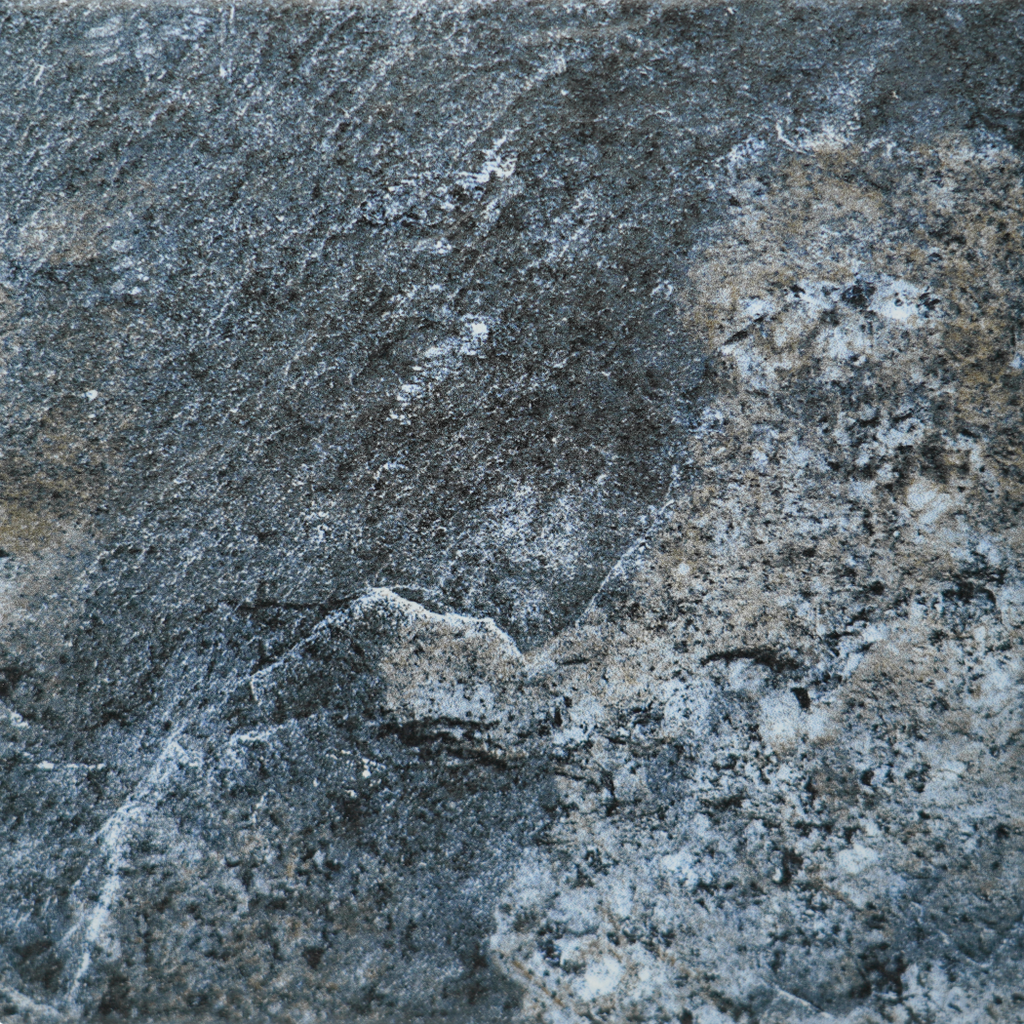

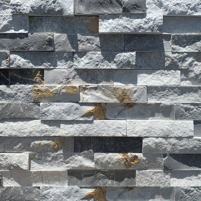

For our finishes we are thinking the following: pour in place coping dark grey, natural concrete deck color, waterline tile- ontario pool tile Pacifico blue, and Ontario pool tile blue pearl ledger stone on the spa and deep end raised bond beam. We are between stonscape micro pebble French grey or Tahoe blue like in the link below.

I love all of your other picks! That is really going to look great when it is done!
