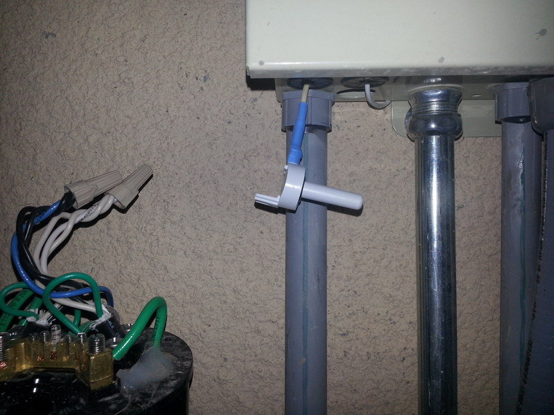

The sensor hanging from panel is just like mine. It is the air Temp sensor.
The one strapped to that pipe is the water temp sensor and is not installed.
There should be a hole drilled in that pipe and the sensor inserted.
The metal strap clamp should be securing the sensor in the pipe.
Not sure what manner of sealant is put where the sensor seats in the pipe.
