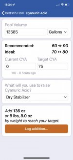

Also figure out why you thought you needed 8lbs of CYA. Something went wrong in poolmath.

You added enough CYA product to get to 90. So I would call it that based on your test data.
I know Poolmath showed that, but you should change the Goal to want you want. I had suggested 40 ppm CYA as a Goal as for the rest of the winter, until about March or so, you will be using liquid chlorine as the SWCG will not operate below 52F water temperature. So you need to follow the FC/CYA Levels for a Liquid Chlorine pool (non -SWCG) until your SWCG is generating chlorine on a regular basis.
That's the problem. So much of the granulated CYA ended up in the MultiCyclone that it's really hard to say how much actually ended up in solution. Hard lesson learned though. As for the target goal, I was just using the default that PoolMath recommended. I have much more reading to do. Thanks again for your suggestions and feedback! Much appreciated!
My CYA was zero and when I plugged that into PoolMath, it showed this...
That may have been the problem. You can’t really tell the difference between zero and 20ppm. If the previous owners had some in there, you may have just been low.
