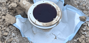

Ok first issue that I ran into and would like some feedback on how you would assess.
After I got everything drained out of my temporary sump pit at the bottom on the pool I noted the main drains looking like THIS:
For context, before the winter freeze I plugged the main drain ports at the bottom of the pool with rubber plugs and filled the line with antifreeze.
On the main drain thats leaking (somewhere), I did try and retape and seal the secondary port (it came with a pvc plug). Filled it again last light and still leaking.
Well Crud, 24 hour leak test. I know for a fact that I filled up the main drain two times this week and it was empty within 12 hours. (1 was pre tightening the secondary drain line plug, 1 was after teflon taping and tightening the main drain secondary plug). After adding the red dye its lost 0 water. Any ideas?
I pressure tested the main drain last fall, so I know it was fine last year.
What I think I'm going to do is put a gasket on both main drains and put a blind flange on each of them and fill entire main drain system with water and pressure test again. When I did the initial pressure test, I didnt really pressure test the main drain itself, I had the line where the drain threaded into plugged with a rubber plug.Screen Shot 2025-03-15 at 11.28.06 AM.png
Pulled off the main drain and confirmed it and the threaded-> socket fitting to connect the main drain to the 2.5" piping is cracked. I must have tightened the rubber plug too tight when I was winterizing the main drain.
