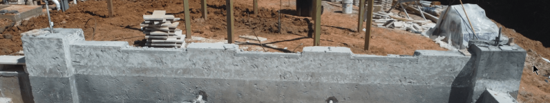

9/19 Construction (de-construction/demo) update.
After determining the beam was constructed too high, the mason crew removed all coping, tile and split-face stone and removed the mortar.
Before:
After (the red line on the gunite reflects how much must be removed - ~1"):
The gunite company is to start shaving the beam in the next day or two.
