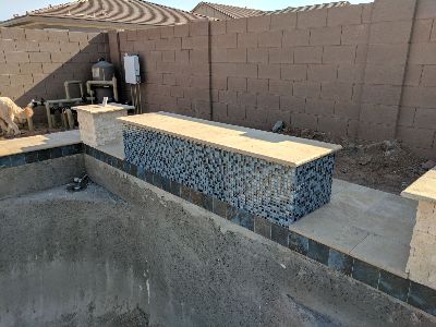

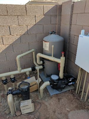

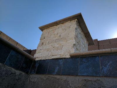

Tile finished, and plumbing painted/protected. 2 days untill pebble!

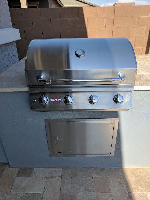

Grill also installed! [emoji1] [emoji1] [emoji1]
I love your tile colors! Is the plumbing painted/protected more necessary in desert areas like Arizona, or should we all be doing that?
Great looking grill! I can almost hear the sizzle and smell the aromas!! Yum!
Suz- in Vegas it's actually part of code to paint the pipes to protect them from the sun. It's a simple process that takes under 5 minutes, so if your equipment is in the sun and you have temperatures over 90 degrees it's a pretty good practice.
It's almost like putting a sun shade up in your car, it's not necessary but they are cheap and they help keep the car a few degrees cooler
Love how everything is turning out MG
Thanks guys. What kind of paint is best to use?
I've used Krylon spray paint with good success. After a couple of years of sun exposure, it tends to dull down. In the 18 years I've had my pool, I've repainted it 3 or 4 times. In Arizona, I've seen mostly light colors - think off white and tan.
Thanks for the explanation. I was not sure if I was missing something regarding concrete pools needing significantly more plumbing compared to vinyl/fiberglass, but sounds like this is for special equipment.
It's an in floor cleaning system. I know most people here don't like these systems, but I've managed my parents similar system for 30 years and it's worked pretty well. This one should work even better.

I think the in-floor system makes a lot of sense for your area or anywhere there's a lot of dust and sand that settles quickly. Especially if you don't have a lot of leaves and floating debris (like my crepe myrtle :roll: ). When I first read about them, I was worried about plumbing under the shell, but I haven't read about any problems at all. I would definitely go with an in-floor cleaning system if I lived where you do.
And I have the same question as AZsunsets: What color is the finish? (add it to your signature, now.... :deal: ) It reminds me of my Blue Granite.
