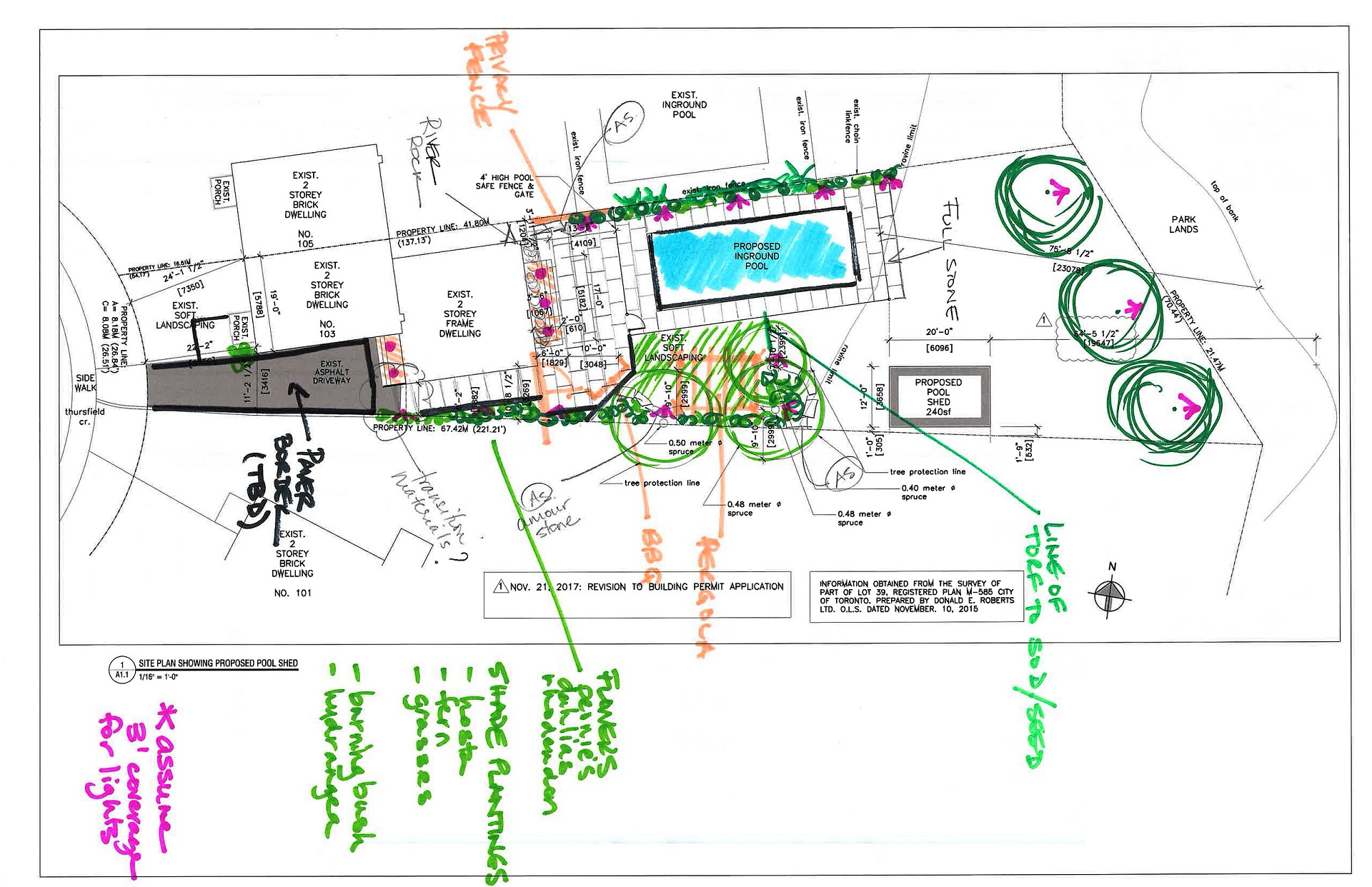

Landscape sketch below. Apolgies for the analog drawing but it works in our process!
We've got lots of patio space - using a 12" dark natural stone for coping and a 16"x32" Grey Oaks Paver.
Approx 1500 sqft or hardscape and 500 sqft artificial turf. The remaining is grass.
There will also be a pergola with roof on the Turf for those rainy days
I'm putting 2 4x4 posts in footings this weekend for some sort of covered bbq station/bar but I don't know exactly what design to go with. Thinking Caribbean style jerk pit with galvanized roof and wood structure.
Appreciate the input on laminar jets and other features. Not interested in something that causes headaches.
What mounts should we look at for sports nets? Assuming this is a sleeve cast in a concrete footing? How does patio stone finish around it?
