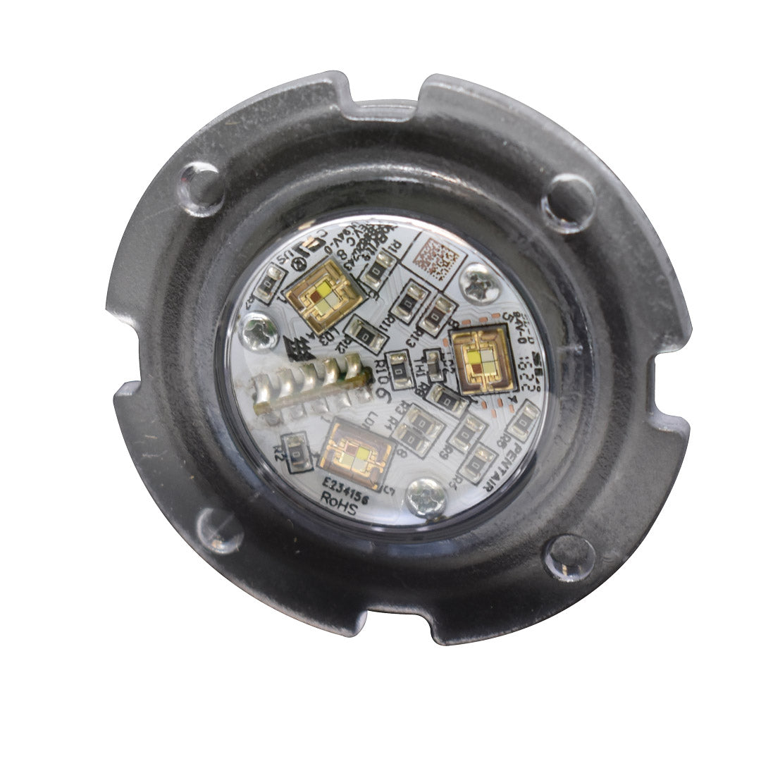

I've got a couple of lights that seem to be broken and I'm looking for replacements (as well as instructional videos about how to go about doing the swap). They're about 3 inches in diameter.
What kind of light is it?
I thought they were intellibrite, but the pictures I see online seem to have a silver border and not show the little notches I see on mine. It almost looks like spots for a tool to grab hold of.
If it can help identify them, my EasyTouch will offer me themes like Party, Romance, Caribbean, American, etc... as well as individual colors. When I switch to a different theme, the lights flash a couple of times before they settle into the new theme. They seem to be LED/low voltage.

OK, I managed to get it out. Now I was surprised to find out that the niche that it was in was not threaded.
I thought the 1/4 turn was to "unscrew" it, but it looks like it was just sitting there held by sheer friction. The rotation seemed to just be enough to "break it free". Is that expected?
I also noticed that the housing of the light seems to have cracked in a way similar to what I've come across many times online - it looks like it is the usual cracking design problem that everyone describes.
What I couldn't figure out is what the caulk-like substance is in part of the crack. Has this been repaired before?
What makes this housing crack? Heat? Is there something I can do to the new one I'm going to install to help with this? I've seen people use some caulk but mostly on the front of the light (by the lens) and in the back, to prevent water intrusion. I haven't seen any countermeasures to address the cracking.

Would be good if you can show the entire label.
I suspect the crack was from water intrusion through the lens seal that then corroded the internals and expanded enough to crack the case. Is there rust inside looking at the lens?
I want to say "yes". Pic attached - I guess I can force my way into it now that it's trash to confirm rust, but the color matches...
What do you think?
That is rust.
