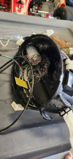

OK just pulled the motor car apart and found quite a bit of moisture and sand stuff all over from the desi. I think it's too absorb moisture. What should i do? Let it dry out and try it again? Is there any test i can run on it to narrow down the problem?1000008310.jpg pak.

I suspect at 5 years the brushes in the motors are all worn out...
Make sure nothing is wrapped around the shaft of the suction motor under the impeller..
You really only have two choices.. Replace the motor box, for $$$$$ or buy a new robot... :(

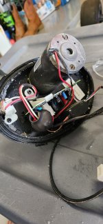

Took a few hours today to open up the SE and cleaned carbon-dusted motor, lubed the O-rings and sealed it back. There was no water or rust inside. it's working like new, going to the water line for the first time in half a year! motor shaft spinning easily when I moved it by hand, and when powered on there was no more loud grinding noise. however, there were 2 large dents (pic), not sure how that happened (?) but I'm guessing that was the cause of the motor noise and self-test failure. Happy for now but not sure for how long.
There is a guy selling motor rebuild kit with Orings on ebay if you want to try it: MAYTRONICS DOLPHIN POOL ROBOT IMPELLER REBUILD KIT MOTOR 52ZY98 5500026 READ | eBay

Those dents are normal marks from the motor manufacturing process. DC motors like that use multiple windings around magnetic poles. To cut down on eddy current loss, the poles are made of laminated sheets of a ferromagnetic material with nonconductive material in between. Because of the non-uniform nature of the laminate and windings, the poles may not all be exactly the same weight. And so, just like a car’s wheel that needs to be balanced by adding weights to the rim, the motor poles need to be balanced as well and they will mechanically shave off some material to change the weight distribution. So it’s not uncommon to see electromagnetic motor poles with machining marks on them.
