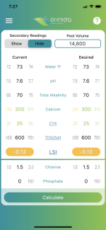

I am going on week three of pool start up for new pebble finish. Wetedge wants the oh around 7.2-7.6 I keep it around 7.5-7.6, my TA has dropped due to the constant acid doses and is around 100 now versus 130-160 previously. If I bring it to 7.5 my lsi is slightly negative -.03-.05, What’s the best way to manage this? At 7.6 it’s .06
