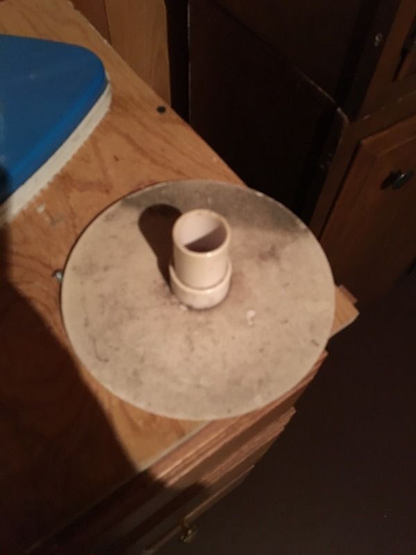

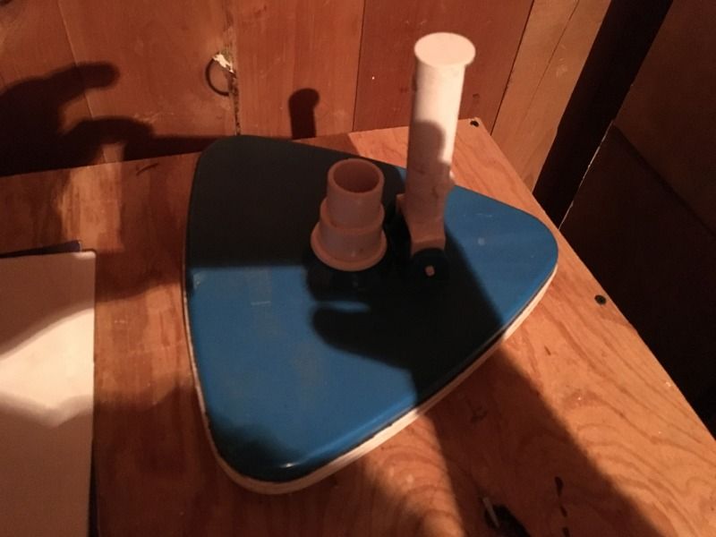

Make sure you sink the whole hose or you introduce air to the pump... bad thing... connect the vacuum.. throw the vacuum in.. roll the hose into the water and once it's full of water connect it to the plate inside the skimmer.. then turn on the pump..

Just thought I would describe for you how I setup my vacuum.
Turn the pump on and let it get running.
Put the vacuum on the pole, attach the hose(it just pushes on), then sink the vacuum in the deep end(I have an in-ground). I just lean the pole up against the ladder and let the vacuum rest on the bottom.
Feed the hose into the water, pushing it down under the water from the vacuum end to the plate end right by the skimmer.
Once I get all the hose fed into the water(it wants to float back up but as long as you feed it from the submerged vacuum to the other end, most of the air will be forced out the plate end), I quickly lift the plate out of the water and place it into the skimmer. Doing this leaves the least amount of air possible in the hose when you connect it to the skimmer.
Hope this helps!
