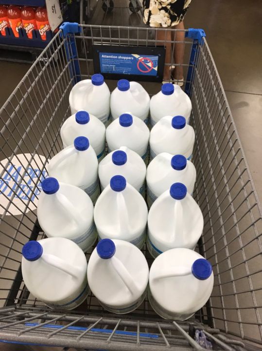

I'll check out the local stores this weekend and pick up a temporary vacuum and try not to lose it in the pool when using it:p. Looks like I'll need to add about 7 gallons of bleach to get it to shock level. Any recommendations on how much I should keep on hand to maintain these levels? I'll also take some pics to update the progress once I begin. Thanks all for the advice so far.
If your pool is very green, I would try to find some more concentrated liquid chlorine, if at all possible, over the 6% laundry stuff.
If you use the 6%, I would suggest your first purchase be at least 25 gallons. And it most likely will take quite a bit more than that.
The Pool Essentials is good.
Check the Julian date. Look for a printed number on the bottle. Needs to start with 19 followed by three numbers. Those are the number of days in 2019 it was bottled. As long as it was bottled in 2019, you should be good.
Noticed that today. Bought 16 jugs at Lowes, the ones with white caps had 19 stamped, the ones with blue caps had 18 stamped on the side. I bought all white capped. $3.86/jug -10% military discount is not bad.
