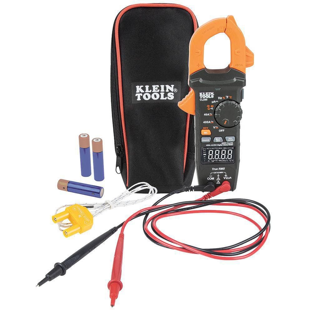

Check the amperage going to the cell.

Did not see any corrosion on the inside when I cleaned the cell a couple days ago. I have a multimeter but not a fancy one like you, mine needs to touch the actual wire. As for what the box says when I first checked it was at 5.1, I pushed the down arrow until it as at 2.8. Assuming I did this correctly?

You can get a clamp ammeter to check the amperage if you want.
Check the amperage in both polarities.
