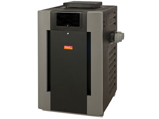

I just finished hooking up the Raypak 266. Now just waiting for everything to dry. 🙌🏻

Andrew,
Great choice and nice job. A couple items to check that I can't see are:
  • make sure you bubble check all gas connections for leaks.
  • have a dirt trap in the gas line as close as practical to the heater.
  • be sure to re-connect the bonding wire.
I hope the heater serves you well for many years!
Chris

Well, some things can never be easy I guess. I’ve waited for the piping to dry, tested for any gas leaks and tried to turn it on last night. The pilot won’t light. I took a video:
It keeps trying and ends up with ignition failure. 🤦🏻‍♂️
My initial thought would be to disconnect the gas pipe to make sure gas is coming through. Can you manually light the pilot? There are numerous warnings saying not to.

I don't hear the gas valve relay click open. Does that happen before the video? If it does, check the gas supply all the way back to the meter. Any valves unintentionally closed?

I checked and it looks like the gas was shut off down at the line. I’ve since turned it on and waited a few minutes. Still hasn’t lit.

Keep trying. It can take 10 - 20 start tries to purge air from the line until gas is flowing. Or get a gas guy to purge air from the line.
The heater will try 3 times to start then throw a fault. Keep on resetting it and trying again.

You have what looks like about 2 feet of 3/4" gas line from the heater to the shutoff valve. When you try to light the heater, the pilot valve opens and i.e. begins to purge out the air in that line through the pilot assembly. Did i mention that the orifice in the pilot is about as big as a pin hole?
Is going to take a while, be patient.

Are you talking about the 1/4 turn ball valve with the red handle in the photo or one further down that is not shown. If it's the one in the photo it can be purged by many start cycles (and I do mean many as indicated by others). If it's way down the line closer to the meter you will need to have the line purged. This should only be performed by an experienced gas plumber.
