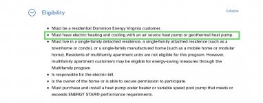

I just checked. Our power company offers a $300 rebate on Energy Star rated VSPs. However, one of the qualifications is we must be heating our house with a heat pump (we don’t have a heat pump). Another qualification is the VSP must be Energy Star rated. I don’t see any such rating on the Century VGreen VSPs. So no rebate for us. 👎
They only issue a rebate on a POOL pump if your house uses an electric heat source ?? That is the weirdest requirement I have ever heard of …
I thought the same! I guess they want customers sending all of their energy dollars to them instead of heating costs going to their competition (Va Natural Gas).
I think that a new variable speed pump qualifies on its own.
The heat pump is a separate rebate.
In my opinion, the rebate details are poorly or incorrectly worded.
Verify to be sure.
Purchase an eligible heat pump water heater and/or variable speed pool pump and have it installed.
Submit a rebate application.
Rebate check will be mailed to the address on file with Dominion Energy Virginia.
Program Eligibility Requirements:​
  • Must be a residential Dominion Energy Virginia customer.
  • Must live in a single-family detached residence, a single-family attached residence (such as a townhome or condo), or a single-family manufactured home (such as a mobile home or modular home). Residents of multifamily apartment units are not eligible for this program. However, multifamily apartment customers may be eligible for energy-saving measures through the Multifamily program.
  • Is responsible for the electric bill.
  • Is the owner of the home or is able to secure permission to participate.
  • Must purchase and install a heat pump water heater or variable speed pool pump that meets or exceeds ENERGY STAR® performance requirements.
  • Heat Pump Water Heater must replace an electric water heater. No rebates are available from this program for non-electric water heaters.
Please review additional requirements through the Program’s Terms and Conditions. By participating in this program, you are signifying your agreement to the Terms and Conditions of the Residential Water Savings Program.
