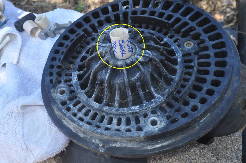

I had to replace the pump seals - here I'm pushing out half the pump seal with my handy dandy pump seal removal tool:
Videos on the web at http://wetheadpumprepair.com said to use silicone seal but US Seal says to use their lubricant and not to use silicone or teflon:
Sta-Rite says in the owners manual to use dish detergent:

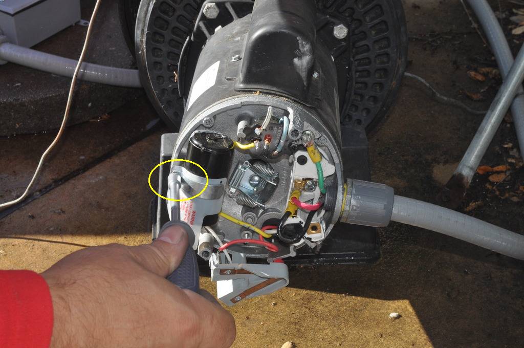

Following instructions at http://wetheadpumprepair.com, I accidentally didn't tuck the yellow capacitor wire away so it wore through in a day:
Here you see the wire repair:
It turns out that the wetheadpumprepair.com instructions are wrong when they say to remove the stationary V switch:
And, they're wrong when they say you need to loosen the capacitor bracket:
My 7/16" inch Craftsman wrench fit on the flat spot of the shaft without having to remove those two components:

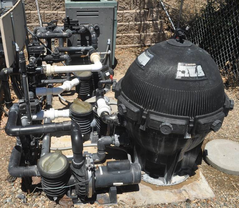

All the leaks but one have now been fixed but I haven't painted the white replacement pipe black yet:

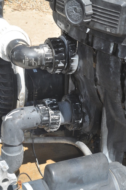

Now the only leak is at the proprietary Sta-Rite unions and the filter itself:
The top (INLET) leaking proprietary Sta-Rite fitting is molded with the following:
UIII 192P THREAD-SLIP UIII 196P-SLIP-THREAD, 2" UNION ASSEMBLIES
The bottom (OUTLET) fitting says:
UIII 192P THREAD-THREAD UIII 193P SLIP-SLIP, 2" UNION ASSEMBLIES

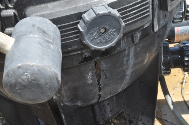

Some of the filter clamps seems to be missing circlips - which I can't find in any hardware store:
Unfortunately, the circlips don't have a part number and the Sta-Rite unions are not on this diagram from the owners manual:
So, the summary is that only the filter is leaking - and I'm held up because I don't know the part number for the o-ring for the proprietary Sta-Rite fittings and I can't find the circlip for the Sta-Rite filter clamp.
EDIT: Calling Pentair, I find the following part numbers:
For the leaking inlet union:
a) Order the Pentair union 1/2 kit -- part # PKG 188 -- each package has (2) each of the union 1/2 collar, adapter & oring
For the leaking filter housing clamp:
b) Order the
Flat washer 38907-0216
Flat washer 24850-0007
Retaining ring 24850-0016
Part # for the o-ring is 24850-0009 (thickness is .575" + or - .015" (30 durometer) with a nominal inner diameter of 25 inches)
Pkg. 188 2" Slip 1/2 Union Kit or Pkg. 189 2" NPT 1/2 Union Kit.
Includes 2 each:
a. U11-200P Union Collar
b. U9-362 O-Ring
c. U11-196P 2" Slip adapter or U11-199P 2" NPT adapter.
