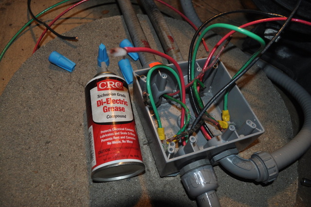

And I made sure to leave at least six extra inches of wire in the junction box:
Since it's outside, I added di-electric grease to all the connections:

I wasn't sure if we're supposed to use di-electric grease under the wire nuts:
And then, just before buttoning it up, I tilted the wire nuts upward, and high:
Here's a birds-eye view of the result, just before putting the waterproof cover on:
