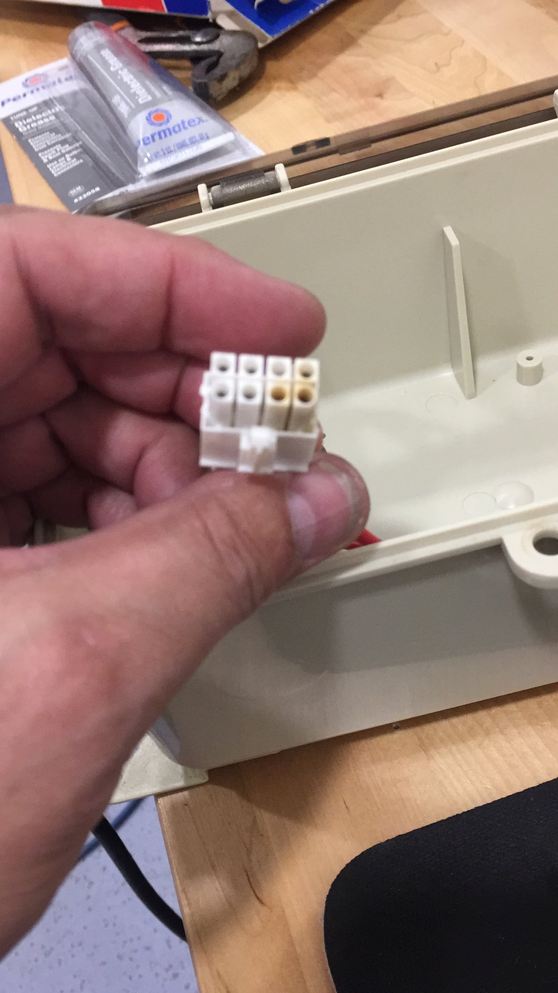

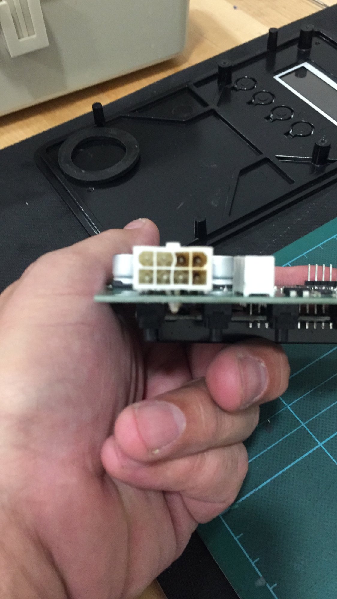

Please post all your intelliPH board / connector fried pictures as I work with Pentair and local warranty / service provider to build a case...
Note: Key Pentair Components in the mix...
Here's mine. I think the black pins are turning dark because of the heat from the red pin connectors, I don't think they are actually overheating. And it makes sense that the hottest pin seems to be the feed side of the power supply. You can see mine was pretty well melted together. Required 2 pair of channel lock pliers (adjustable pliers) and some persuasion, to get it to come apart.
EQUIPMENT - Intellicenter I8PS, IntellipH, Intellichlor IC40.
Posted about my fix here... IntellipH Burned Connector Fix
