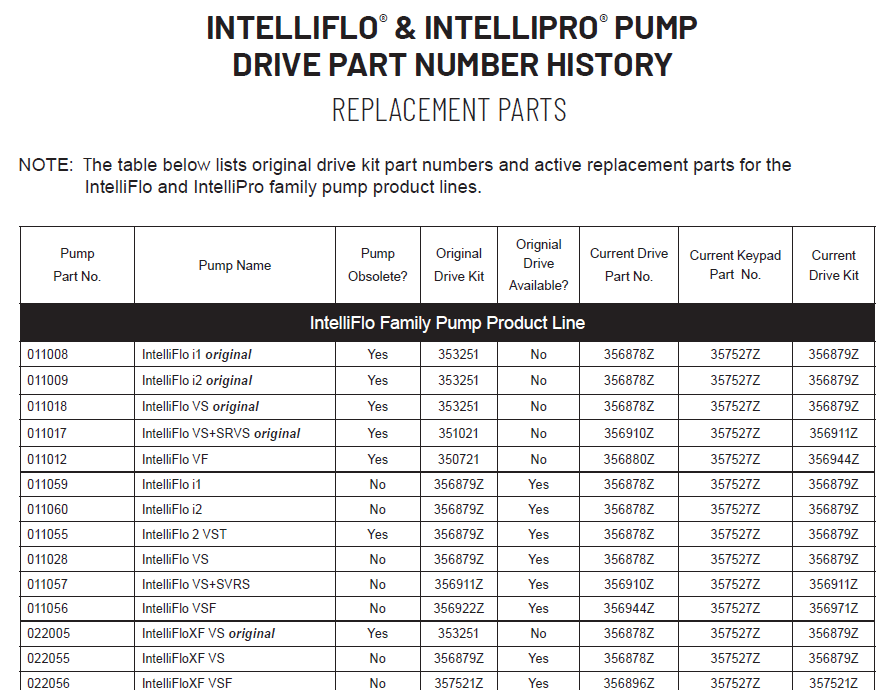

You will probably need a new drive.
VS pumps with electronic controls do not have simple motor windings you can check. The motor is the IntelliFlo is different from the single-phase induction pool motors on the most residential pools. The motor is a Permanent Magnet Synchronous Motor, which instead of having a rotor made up of shorted copper bars (otherwise known as a squirrel-cage rotor), has a rotor with a bunch of powerful permanent magnets.
The drive is the electronics that sit on top of the motor and control the motor speed.
Pentair does not sell a control board. They sell a complete drive that is bolted onto the motor.
