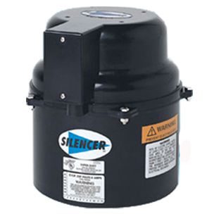

Spa is about 50 feet from equipment. Is it as simple as just cutting off the 2 inch pipe just below the existing orifice, inserting a check valve and set the blower motor on top? Do I need to worry about airloops or back pressure calculations?
I would give it a try but not cut the pipe yet. Remove the cap and duct tape over the orifice, put the blower on top, and see how it works.
You don't need a CV as water clearly does not come up that open pipe.
I wonder about the jet nozzles you have and if they may cause a problem with the blower. And we don't know exactly how the air loop was plumbed.
If things don't work you just untape the orifice and you are back where you were.
Give it a try and let is know how it works out.

If you are not getting much air then a blower may be a good solution. But sometimes people do it for stronger jets but extra air does not always result in stronger jets. That has more to do with water velocity than air velocity.
I recently added a 1.5 horsepower blower to my existing six jet spa. My vent is similar to yours, with the same cap and orifice (probably the same pool builder out of Riverside). If you're after "thump," that's a great way to describe what I got. You can feel it in your chest, like standing next to a speaker at a rock concert. It's loud and definitely adds more air/agitation to the spa. Without the jets on, all you get is large air bubbles directly above the jets at the waterline. I added a diverter valve that allows me to adjust the amount of air directed to the spa. It's a bit intense at full pressure. Sitting in front of a jet results in water/air being blown up to the back of your head and over the edge of the coping. I think mine would have worked well with a 1HP blower.

Forgot to mention...one concern I had was losing bubbles with the blower off since the air vent would no longer exist. I still get the same amount of bubbles with the blower off as I did prior to installing the unit. The blower allows air to pass through when off.

I added a 1HP Polaris QT 110V blower by just cutting off the top on the 2" PVC. Taped over the orifice. It's pretty quiet.
The result is EXACTLY what I was going for.
With the spa jets on I get a nice added "Umph" to the back massage.
Without the jets on, the result is different and powerful.
No bleed off valve and no holes drilled in the pipe as of yet.
