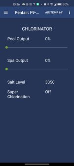

Screenologic Connect app shows:
"FEATURES" list: Waterfall, Spillway, Jets, Cleaner (no Spa).
"PUMPS" list: Pool, Spa, Jets, Spillway, Cleaner, "Pool or spa heater active" and "Solar active" (no Waterfall)
Both screens list Edge pump and Spillway and Cleaner so at least those 3 are consistent.
Edge seems to suck water from the bottom of the infinity edge well and pump it into the main pool if the float in there is in the up position (water level above it). Edge pump won't turn on if the float is in down position (water level below it) and is adding water to the infinity edge well.
Spillway seems to pump water into the main too through the same openings as the Edge pump, but keeps going until the main pool water level rises and starts spilling over into the infinity edge well....once it gets there, Edge pump can shut down.
Jets seem to be the spa jets, which I don't think are needed to balance chemistry, right? Is it just for use when you're enjoying the spa?
Cleaner seems to be the suction at the connection for the Vevor vacuum we use. If so, that seems to need 2600+ rpm to function. But can I run it at 2600 and everything else at 1200-1600? I'm thinking no. If not, I guess I could just do the vaccuum every Saturday or something with everything going 2600.
Pool. I guess since this pump runs the spillway, spa, and cleaner, it automatically is on if I toggle on any of those, and this is why I don't have a separate "Pool" toggle in "Features" to turn it on? But why are their separate rpm pump settings for Pool, Spillway, Spa, Cleaner then? Don't they all have to be the same since they're all running off one "pool" pump? Will it just default to the one running at the highest rpm?
Solar Active: I believe this is running off the main "Pool" pump too. I assume I could run it at any speed, but it would probably heat faster if I ran it fast.
Spa heat: If I want to run the Spa to allow the Spillway and/or Cleaner to run off of the "Pool" pump, but don't want to heat it, could I just leave the temp setting well below current temp to be sure the gas or solar heat don't kick on? That seems to be the case.

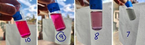

When testing CH, use 10 ml of pool water. 10 drops R0010, a few drops of R0011L, and then each drop of R0012 is 25 ppm CH.

OK will retest with smarstir, wife, etc for sure, but in the photos above doesn't it look like 14 did show the full color change (that's why i started the photos there)...and I don't see a difference as more drops added. In the "tap by BFV" photos, which do you think is the true level?

Also been working on pH and FC more, and got them decent so I retested everything. Here's what I think these read:
pH 7.5
TA 90
CH 33x25=825 (Tap: 6x25=150)
CYA 25?
Temp 72
Salt 3340
CSI 0.14
FC 3 (-TC 3=CC 0)
Do you agree with my readings from these photos?
(My daughter wanted me to point out to the TFP team again that the color for CH testing is not blue but is lavendar as evidenced by the fact that it matches the color of the lavender syrup they use in their with their bouge espresso maker) ;)

TA 7 8 9 10: 9
