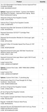

This is my first post, but likely not my last over these next 6 months. I just paid the deposit on a 16x32' Equator/Latham steel wall in-ground pool kit to be delivered in April 2022. Planning on doing the installation and landscaping myself this spring/summer. Very excited and just a bit nervous. I'm a project manager and like to have everything planned out well in advance and leave very little room for error and uncertainty. I've got some questions below, regarding the final depth and the best way to resolve an issue with mounting the acrylic step on the long side of the pool. See my attached diagrams for visual reference.
