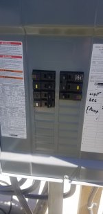

Did you check the GFCI reset on the CB?
Post pics of the pump and the CB.

If you press the 'Test' button on the GFCI pump breaker, does it trip as expected? Try resetting the breaker by flipping it off and then back on.
I did hit it n it went to the middle so it works. I was reading the manual n it said something about shutting it off for 5 minutes to drain voltage? I have it shut off at the breaker.
I've been flipping it n the only thing coming on is my temper. I got nothing.
