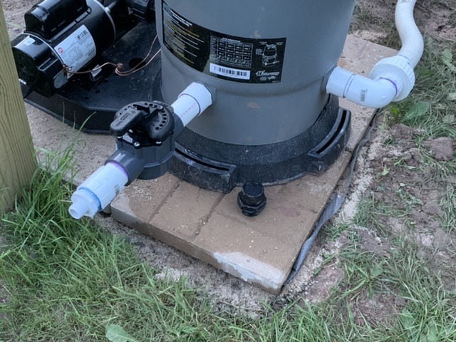

Thanks. I was wondering if there was an easier way by adding a pipe to the drain with tap. But maybe it’s not worth the trouble if I can just use a shop vac.
If you have room, you can add a pipe with valve off the drain. Easier to do before the filter is installed.
I have an AGP, but here’s what I did with mine. Similar concept to this.
This way I can connect a garden hose to it, open the valve, and direct it wherever I want.
