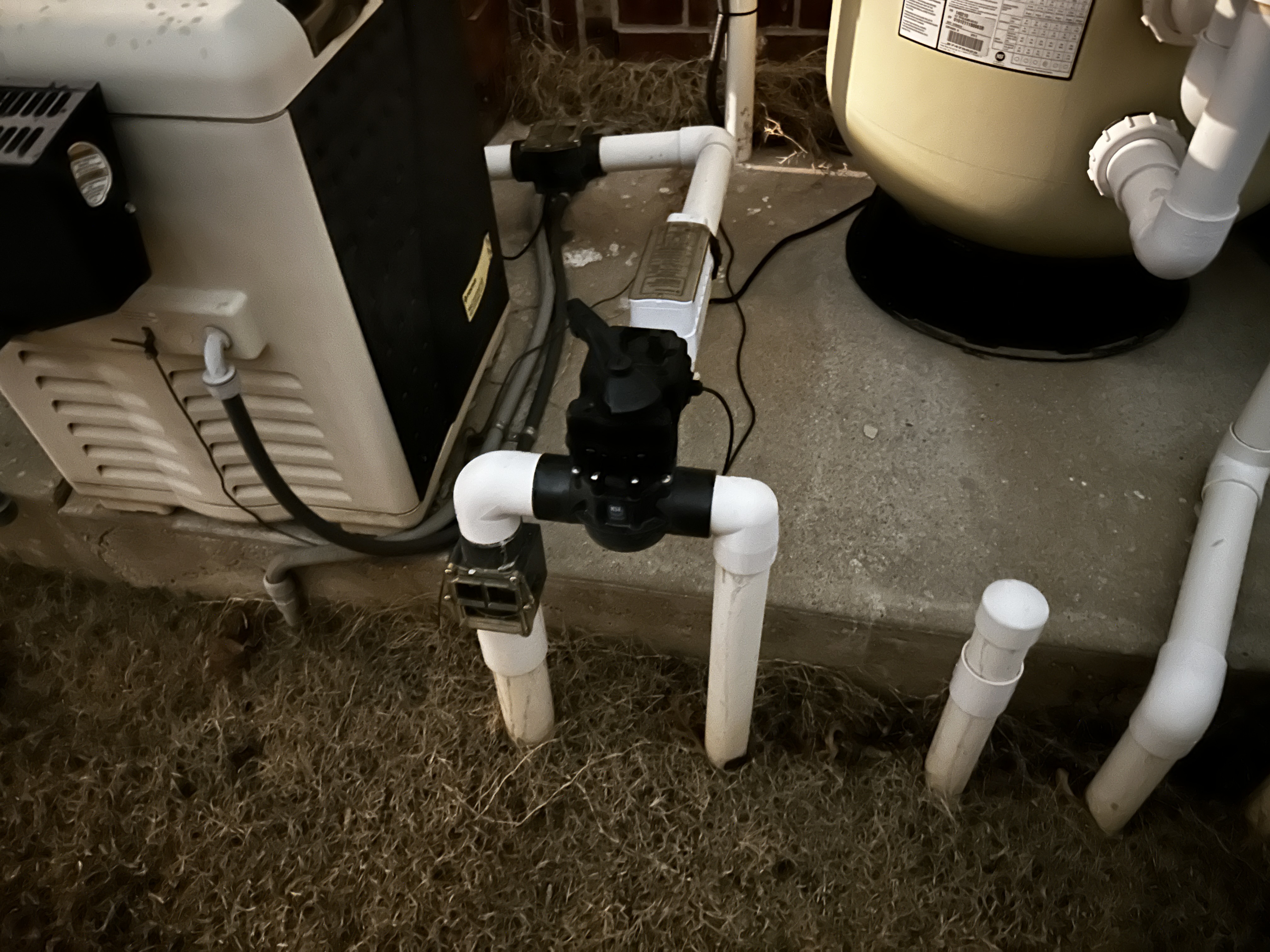

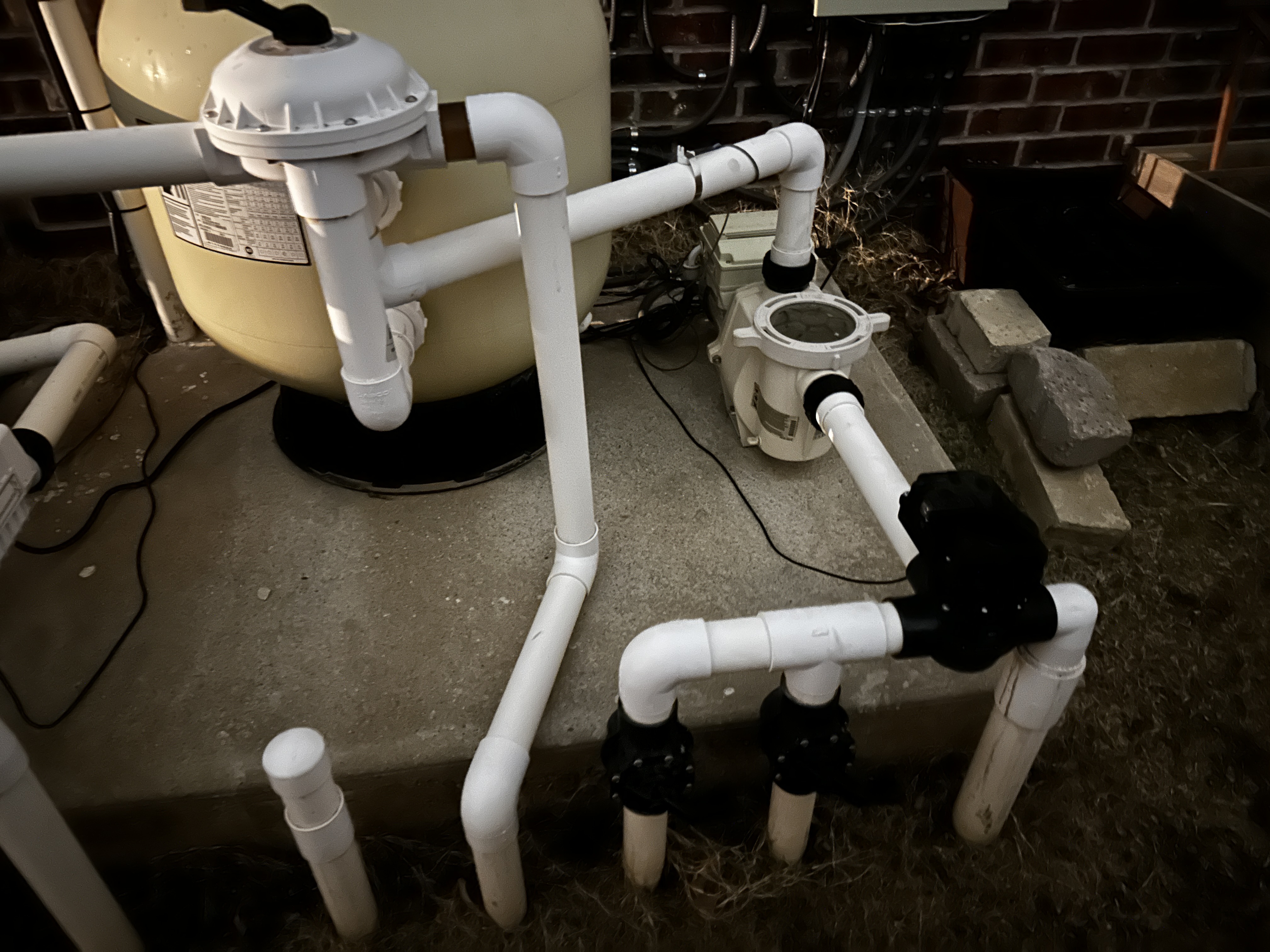

Ok, here are pictures of the pad..
Off the back of the heater, two check valves, one in front of the diverter and one behind to the return (I am assuming the SPA), second one is the pump and inlets, which I am going to assume is the skimmer, and one for pool vents and one for spa vents (with valves)?? or is it one pipe for the pool and two pipes for the spa? (looking at diverter).. One thing I noticed is that the vent pipes, both of the valves are in the left/right position, not up/down.. is that correct?

Thanks for the pics,
Salt pools do not cause your plaster to fail any more than a standard chlorine pool...
Open the check valve that is after the salt cell and Return valve. The pipe on the left with the check is the line going to your spa.
Normally this would cause the spa to drain down until the water is below the jets, but it can't hurt to look at it and make sure it is ok.

I inspected both valves, one to spa and one back of heater.. The valve that is off the back of the heater is completely shot, looks like the spring is done as the flap is open when system is not running. SPA valve "seems" closed, but I can tell you that neither of them have been serviced probably since build. You can usually tell is the screw heads have been loosened/tightened previously.. they look untouched.
I have two new re-valve kits coming in, so let's see what they do.. I have a feeling that this will resolve the issue.. while I am at it, is there any other valves/gaskets I should look at? I figure if I am going to have it down and apart, I might as well knock out all I can..
