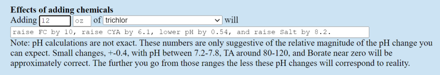

Use 'effects of adding' in the upper left menu in poolmath.
Select trichlor and enter the amount to see the FC and CYA added.
It's a great tool for anything else you could possibly add also. Get familiar with it. :)

10 ppm FC added by trichlor raises the CYA by 6.1, lowers the pH by 0.54, raises the salt by 8.2 and lowers the TA by 7.1 ppm.
10 ppm FC from Trichlor:
Raises:
CYA by 6.1
Salt by 8.2.
Lowers:
pH by 0.54.
TA by 7.1.
