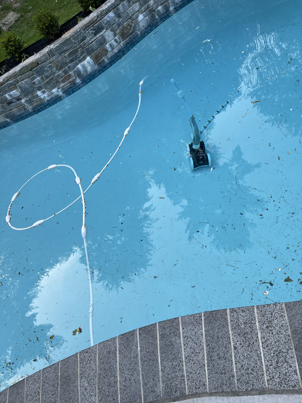

The pool opened (became ready to use) the day the owners left, so I don't think they could answer this question. I'm trying to clean the pool. I went to features > pool cleaner > pool and then got the interlocked screen (ss2). On/off is not actionable. Figured out how to go past this screen to schedule the cleaner (ss1), but the on/off button doesn't seem to work here either.
There was no skimmer net when I got here (it has arrived since), and trees etc are flowering (ss3) so lots of debris that sank. Anyway, the pool is going to be a hot mess when the owners get home and I'd like to fix that. Any suggestions? Please and thank you!
(I do not know much about the pool specs, sorry. It's a Hayward interface.)

Thanks for the response! The owners will be back in 2 weeks. I did not ask them because the pool opened the day they left; I don't think they know much more than I do about the interface and actions. No instructions. I figured out how to heat the spa (and turn the heater off). Pool temp is set. I'd really like the pool to have less debris in it (it's spring here, so lots of stuff in the air) when they get home. It was clean when I got here. :) Since I didn't know where the skimmer net was, a lot of stuff sank.
