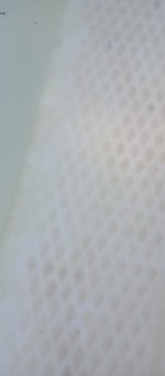

Ok cool. So I can test for CYA and it be accurate even during the SLAM? How should I bring the CYA up? The sock method or can I add it straight to the water to raise it quickly? Also i have this beige colored stuff that keeps settling on the stairs and floor of the pool. When I brush it it kicks up everywhere... Dead algae im guessing?? Its not dirt, when you try to touch it it literally disappears...

Will do. I am going to lower my PH then add the CYA sock and resume my SLAM! Thank yall so much. Oh did anyone see the photo I posted and asked about the dead algae..?? I guessing that is what it is but im not 100%
Really hard to tell in the pic. But dead algae will begin to transition from having color to light grey/off-white.
