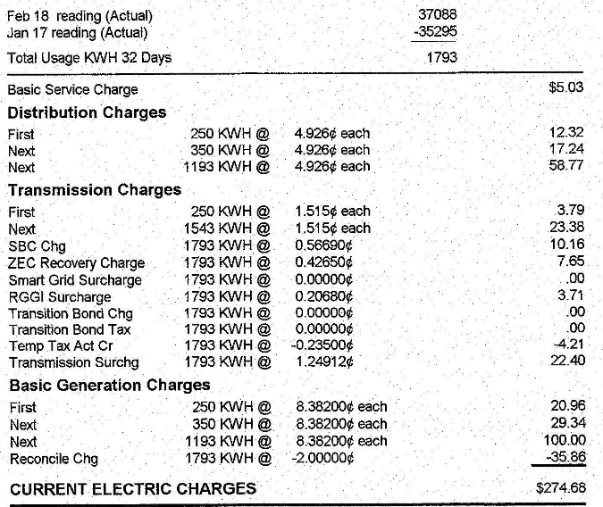

To calibrate your $300-$400 /month electric cost we need to know your fully loaded KW/hr cost, what months are that cost, and what water temp you heat to?

I’m not sure what you mean by “fully loaded KW/h“ - can you explain or is that in the calc information you shared already?
Look at my electric bill below. My basic electric charge is 8.382 cents but then there are distribution charges and transmission charges.
So when dividing the actual usage of 1793 kwh for the month by the $274 my fully loaded cost is 15.28 cents/kwh.
