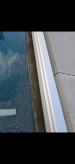

Our bluestone edge where the water touches/the automatic cover retracta is discolored splotchy orangeish now.

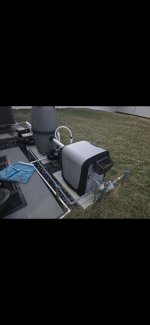

Show us pictures of the heater.

Please see attached pics. Let me know if you need more.

Did your builder open up the heater internals and examine the heat exchanger?
I believe what you see is the copper heat exchanger deteriorating from poor water chemistry and causing copper staining.

He didn't open up the heat internals. I will suggest that.
He also said "there was debris in the water diverter which is causing the heater to heat water too hot" He cleared it out and said it should be fine now but he expects more issues with the heater going forward.

Came home from work to a guy installing a new heater. The guy said he has had to replace so many Jandys bc of issues and so our pool builder got this one. He said Jandy was also slow to respond to the issues/concerns.
Thoughts?
