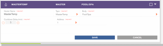

I don't know why your firemans switch control did not work but I would rewire it for RS-485 control.
You need to reconnect the firemans switch wires in the heater and use the same cable yellow/green wires between the Comm connector on the heater board and the Comm connector in the IntelliCenter. Then change your gas heater configuration to Connected Heater as discussed above.
