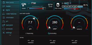

When pump off:
When pump running with 85% speed just now:
The ORP drop to 280 and ph is 7.7, now,, this morning was 600 and 7.5, the ph is also raising fast, today is 50% rainning day.
