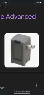

Is the serial number before or after 3X21153-8045543?
Does the unit have a pressure switch or the older style tubes and differential pressure switch?
Was the pressure sensor disconnected?
