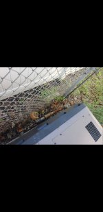

Heater located in a corner outside near the house. I had a professional company install it, the only problem is they aren't repair techs and I'm having a hard time finding an authorized tech to come take a look since it's still under warranty. I never could smell anything before firing it up this year.

Found the culprit these little seeds were getting blown off the bush near the heater and made it through the grates of heat exchanger. There was a whole bunch i got in there with a vacuum with bristles and got it working. Smell is gone.
