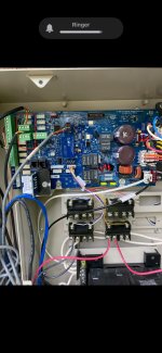

If you have 4.1 or newer you should be able to update from Wi-Fi. I would recommend doing that. OmniPL has 2 versions and it is hard to see what driver you need from Haywards website. OmniPL pro has 2 comm buses for pumps in top right. OmniPL plus only has 1. Pictured is the OmniPL pro
