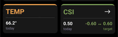

Your Aqualink should display water temperature
Ah, that's helpful. I don't have mine set up yet due to it being in service mode... but I'll use that once it is...
